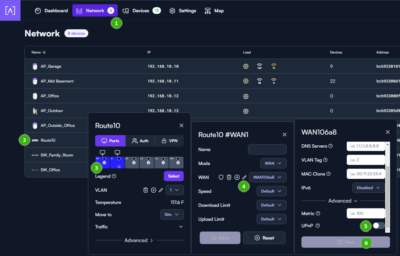

How to Enable UPnP?
  1. Start on the Network tab at manage.alta.inc
  2. Click the Route10 icon
  3. Click your WAN interface (W1)
  4. Click the Pencil icon next to your WAN drop-down
  5. Enable the UPnP toggle
  6. If desired, adjust the UPnP VLANs to reflect the only VLANs allowed to leverage UPnP
    1. For example, Guest networks/VLANs should not have the ability to leverage UPnP for the sake of security and best practices
  7. Click Save
Note that UPnP can only be enabled on one WAN interface. The nature of how the protocol functions does not allow for multiple WANs.

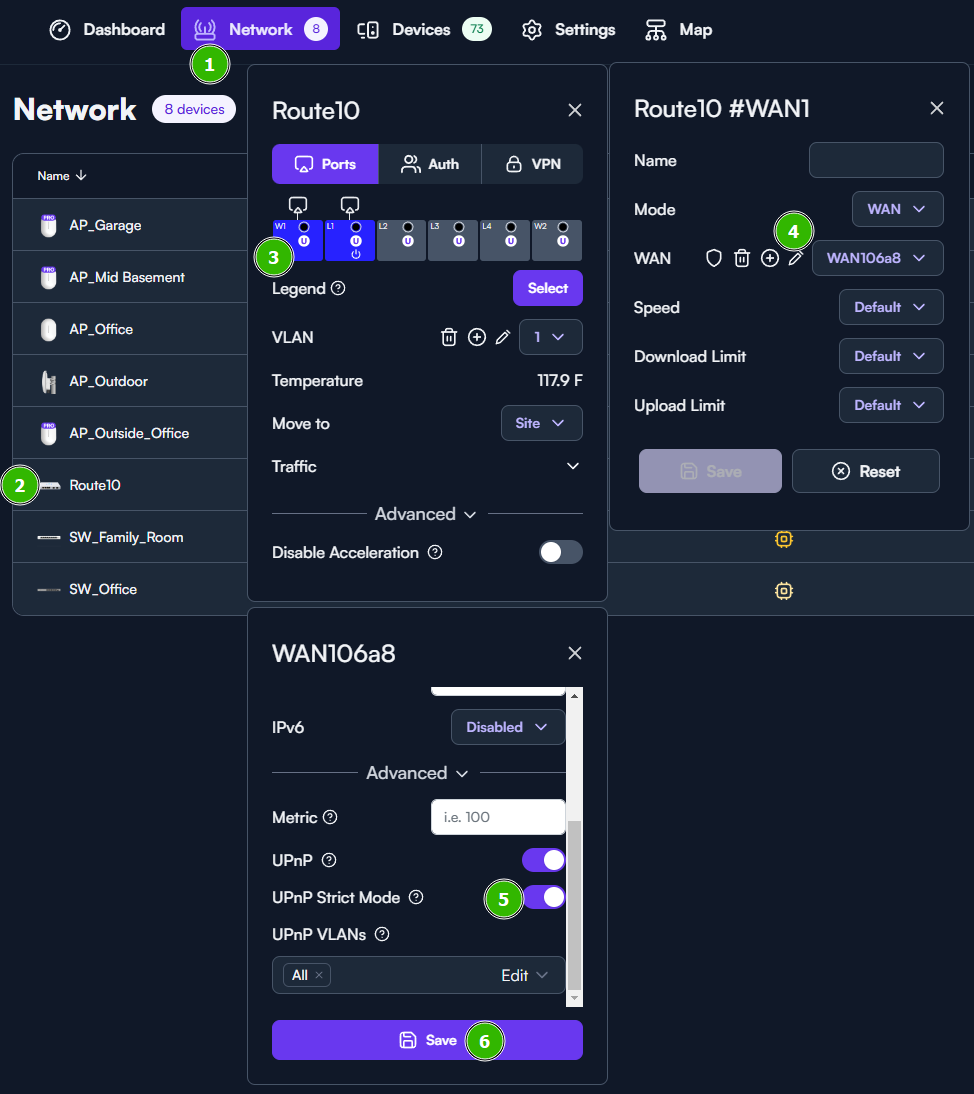

Enabling the UPnP Strict Mode globally:
  5. Enable UPnP Strict Mode
  6. Click Save
In this state, no clients will be permitted to use UPnP. Permitted clients must be expressly configured next.

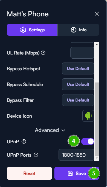

Allow a Client to Leverage UPnP under Strict Mode:

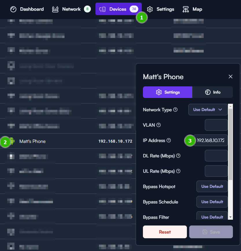

As a prerequisite for using Strict Mode, the client must be given a “sticky” IP address.  A sticky IP address is simply a reserved IP from the DHCP pool, ensuring that the client gets the same IP address every time they are on the network, regardless of how long they’ve been disconnected from the network. The DHCP server will never provide that address to a different device unless the sticky assignment has been removed.
  1. Start on the Devices tab at manage.alta.inc
  2. Click the icon of the desired device
  3. Provide the sticky IP address
    1. The device’s IP can be copied and pasted or manually entered
  1. Toggle UPnP, and populate UPnP Ports if desired. If UPnP Ports is left blank and the toggle is enabled, the device will be allowed to open any port to itself. The UPnP Ports field can be populated with a single port, or a dash-delimited range of ports like 1024-65535.
  2. Click Save
  3. Repeat for any additional devices
