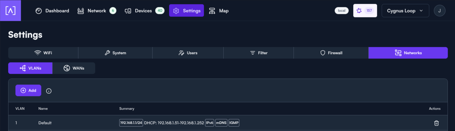

You may create VLANs from the main Settings -> Networks by clicking the Add button, or edit an existing VLAN by clicking its Name.
