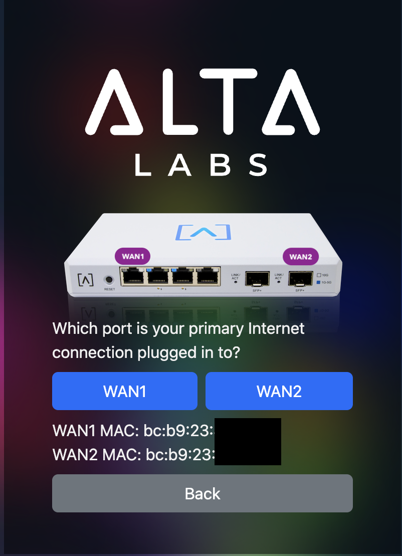

Confirm which WAN interface you have connected
Ensure that you select the correct port corresponding to where the internet connection is plugged in.

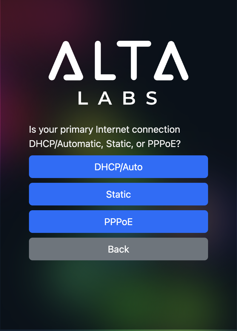

Configure your IP address settings
Most connections will simply use DHCP/Auto here. If your ISP offers you a static address or PPPOE connection, they should be able to provide you with the necessary details.

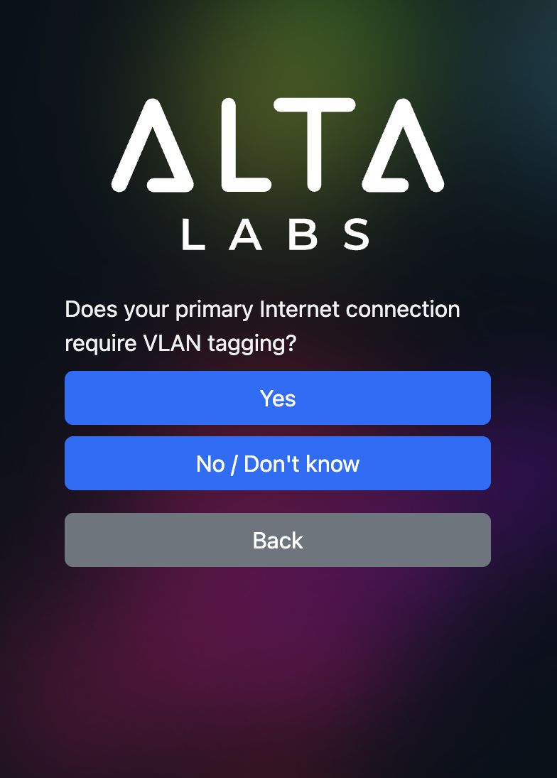

Define VLAN tag
Your provider may require a VLAN tag in order to correctly connect your router.

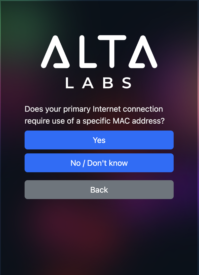

Clone a MAC address
Some providers will only authorize a single MAC address at a time when allowing connections to the internet. You may try to clone it here by inputting the MAC address of your prior router. Otherwise, you will need to contact your ISP so they can authorize your Route10 on their network.

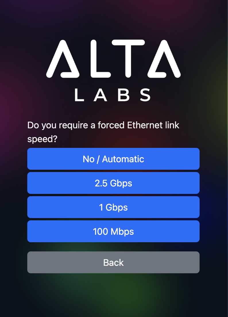

Set the link speed
Most connections will automatically determine their link speed, but you may manually configure it here.

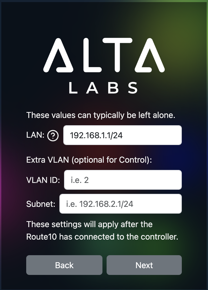

Default Subnet
Optionally, you may change the default LAN subnet for VLAN ID 1 and enter an extra VLAN + subnet in case you have some critical infrastructure running on an alternate VLAN.
