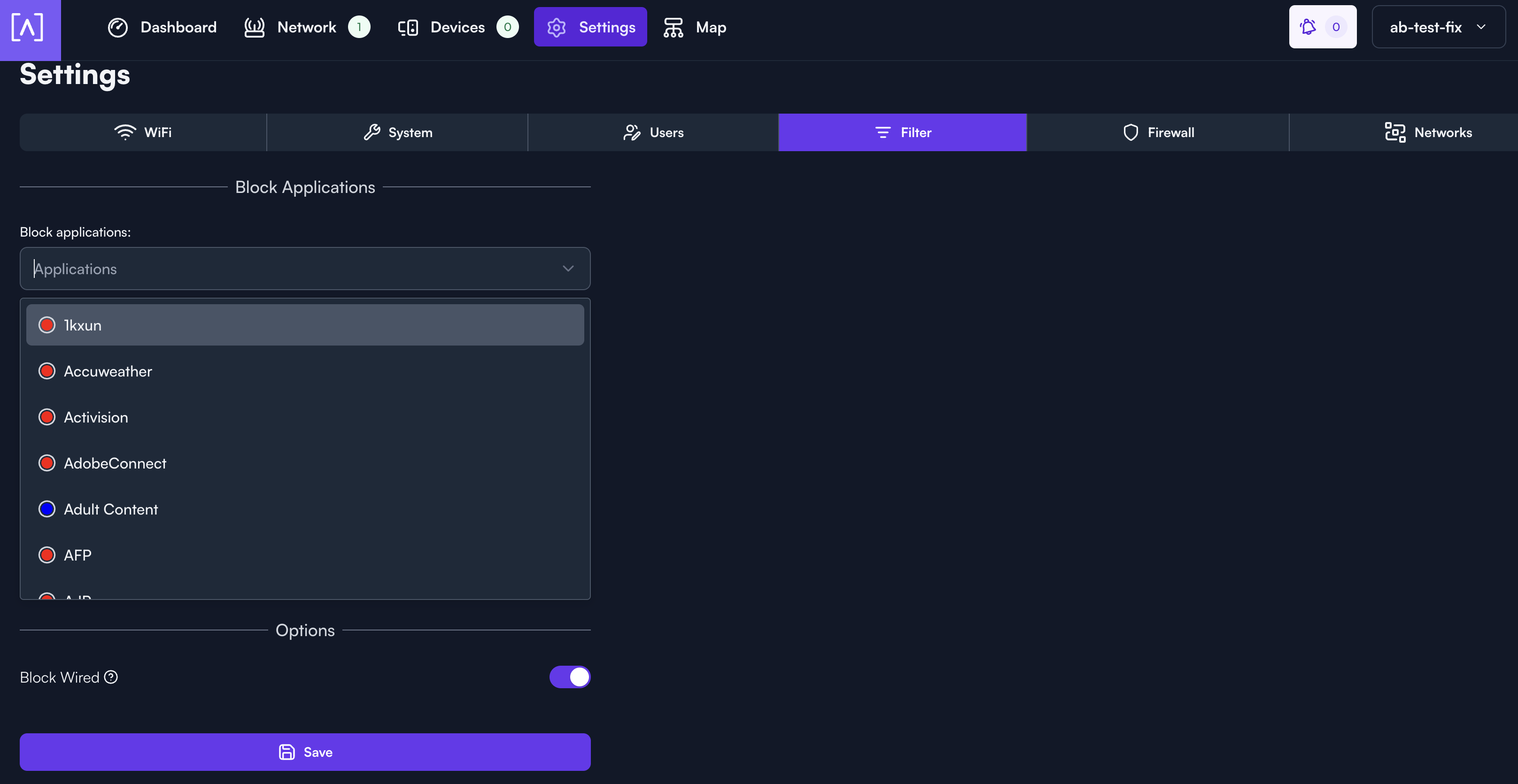

If there is a Route10 present on the site then it will also apply to all wired devices if the Router Block option is enabled. As of January 2026, there is not a bypass option for traffic traversing Route10, but that will be implemented in a future update. That means it's all or nothing for wired devices at this time. This is controlled by the Router Block toggle found at the bottom of the Access Points and Routers Filter settings.

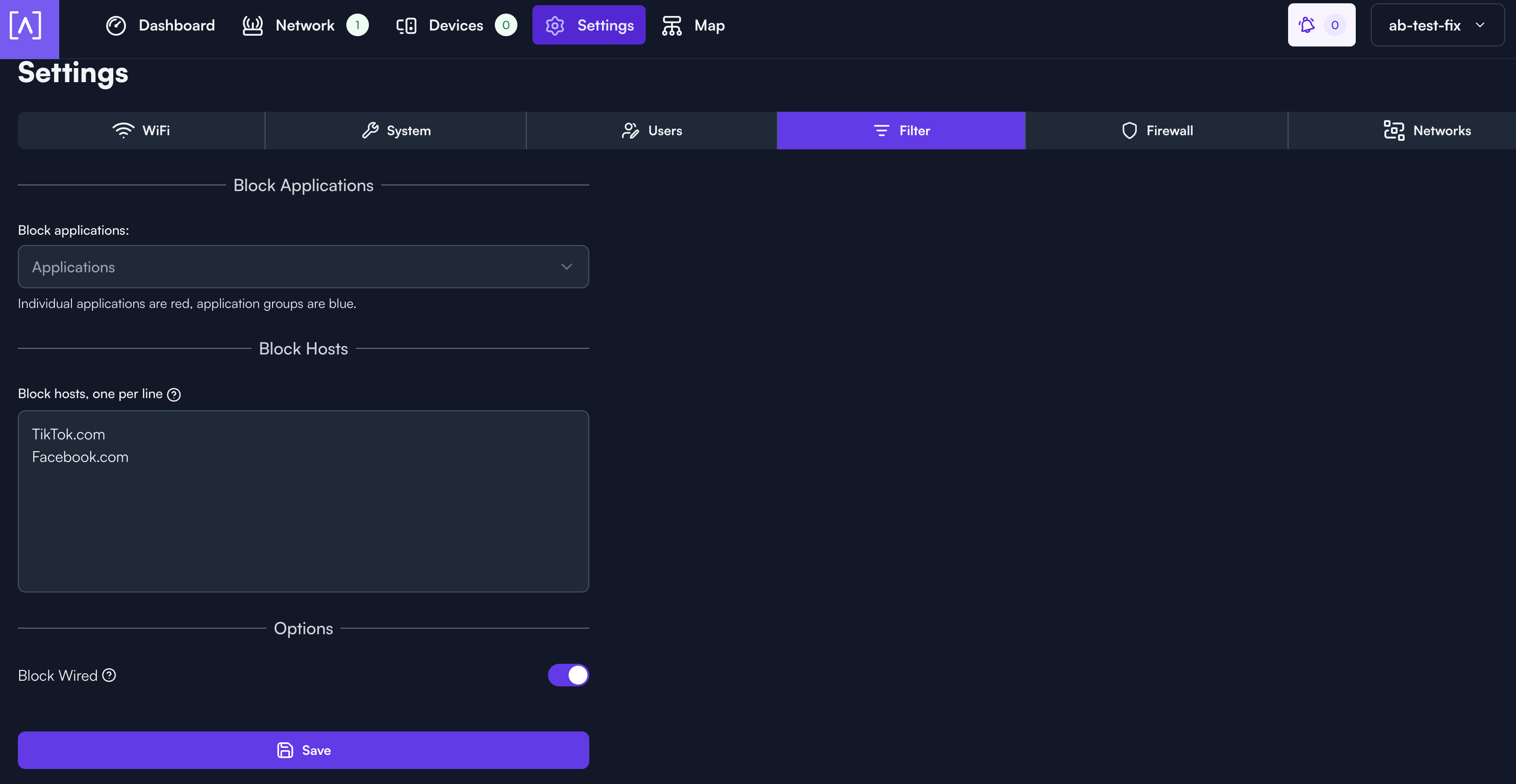

Set a Filter Policy

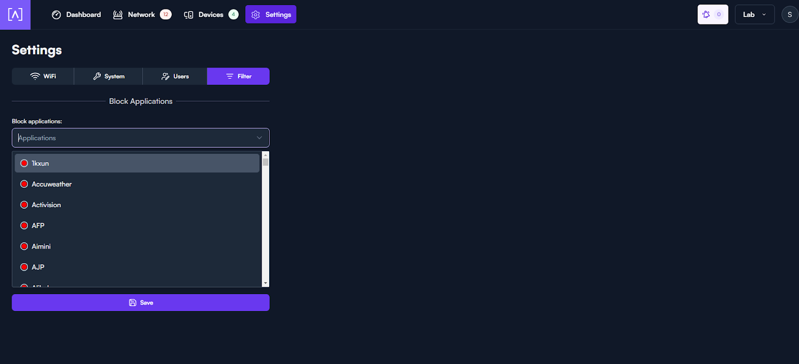

First, log into manage.alta.inc, then select the site you would like to create a filter policy for. You can find your sites using the drop down menu in the upper right hand corner of your screen. Now, select the settings tab. From the settings tab, you will select "Filter". Two different menus will appear. First will be the "Block Applications" drop down. You can select as many different applications by name or application groups as you want. You can start typing the name of application or application group and the list will be filtered as you type.

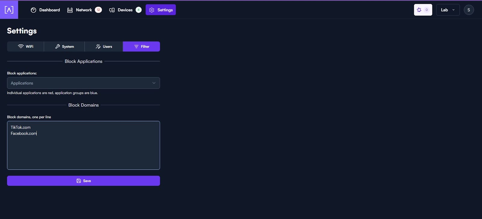

The second menu lets you enter specific website names. For example, if you wanted to block TikTok or Youtube, you can enter Youtube.com or TikTok.com.
Once you have entered all of the domains you wish to block, be sure to hit save.

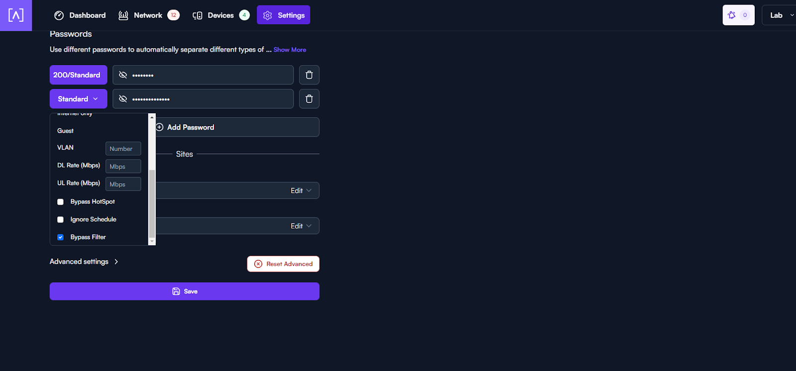

If you have users who don't need to be governed by the filter policy, you have the ability to bypass the filter using our Multi-Password technology. To enable this, head over to "Settings", navigate to the SSID you are applying the filter to. Then select the password policy you want to have ignore the filter policy. Click on the purple button that is named after the password policy you have selected. Scroll to the bottom of the drop down menu and select "Bypass Filter". Now, make sure the password policy that will use the filter policy, does not have "Bypass Filter" checked. Hit the save button and you're good to go!

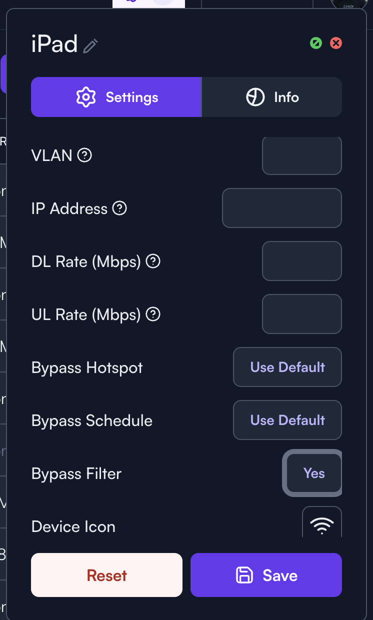

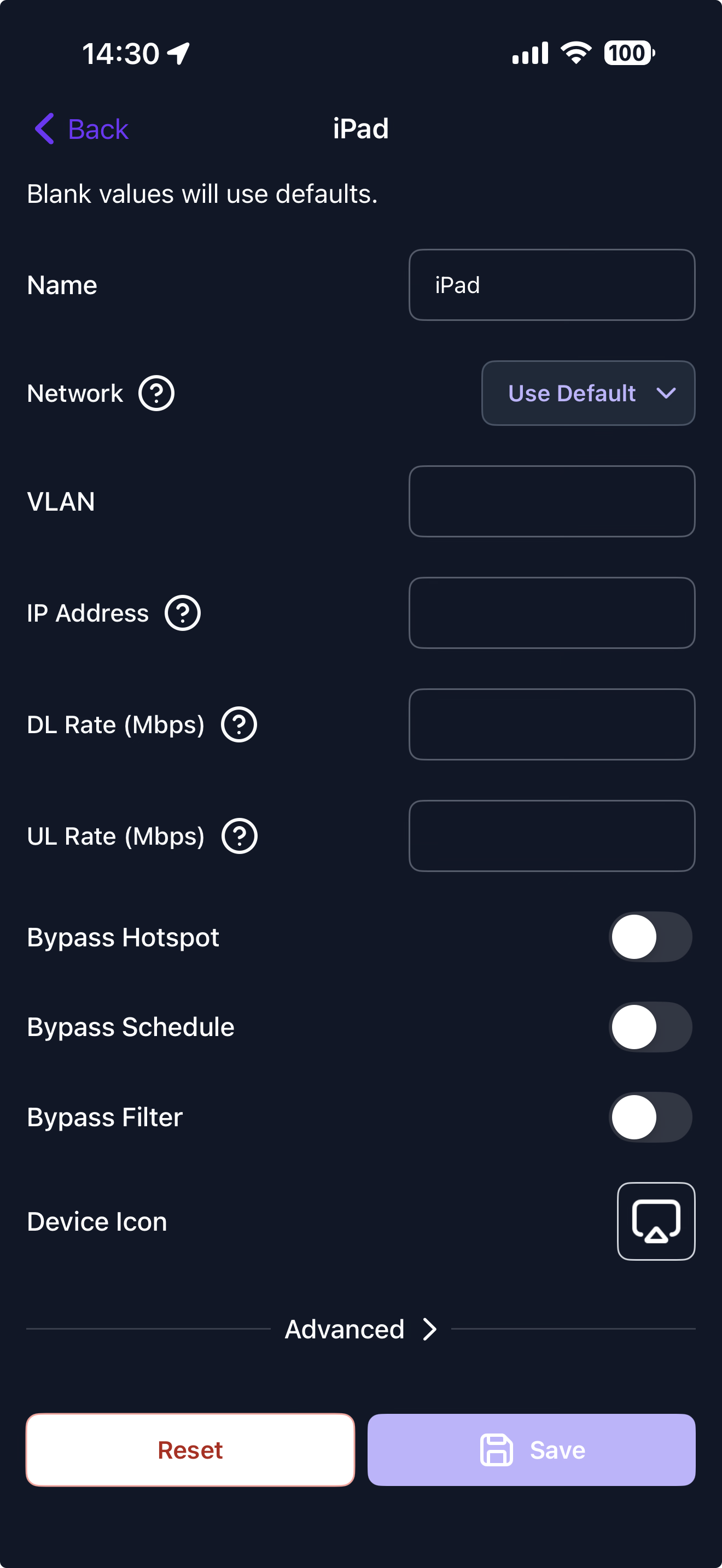

The bypass isn't just limited to the password, but obviously that is the easiest way to set it at scale. That said you can also set it per-device. Obviously this doesn't scale as well, but it does allow for more flexibility. You would go to Devices, and select the client device from the list that you want to perform the override on. From the web you scroll to where it says Bypass Filter and change it from Use Default to On, then choose Save. From mobile you choose Edit, tap the Bypass Filter toggle to turn it on, then choose save.
