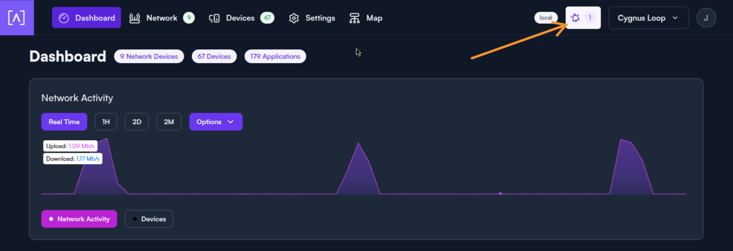

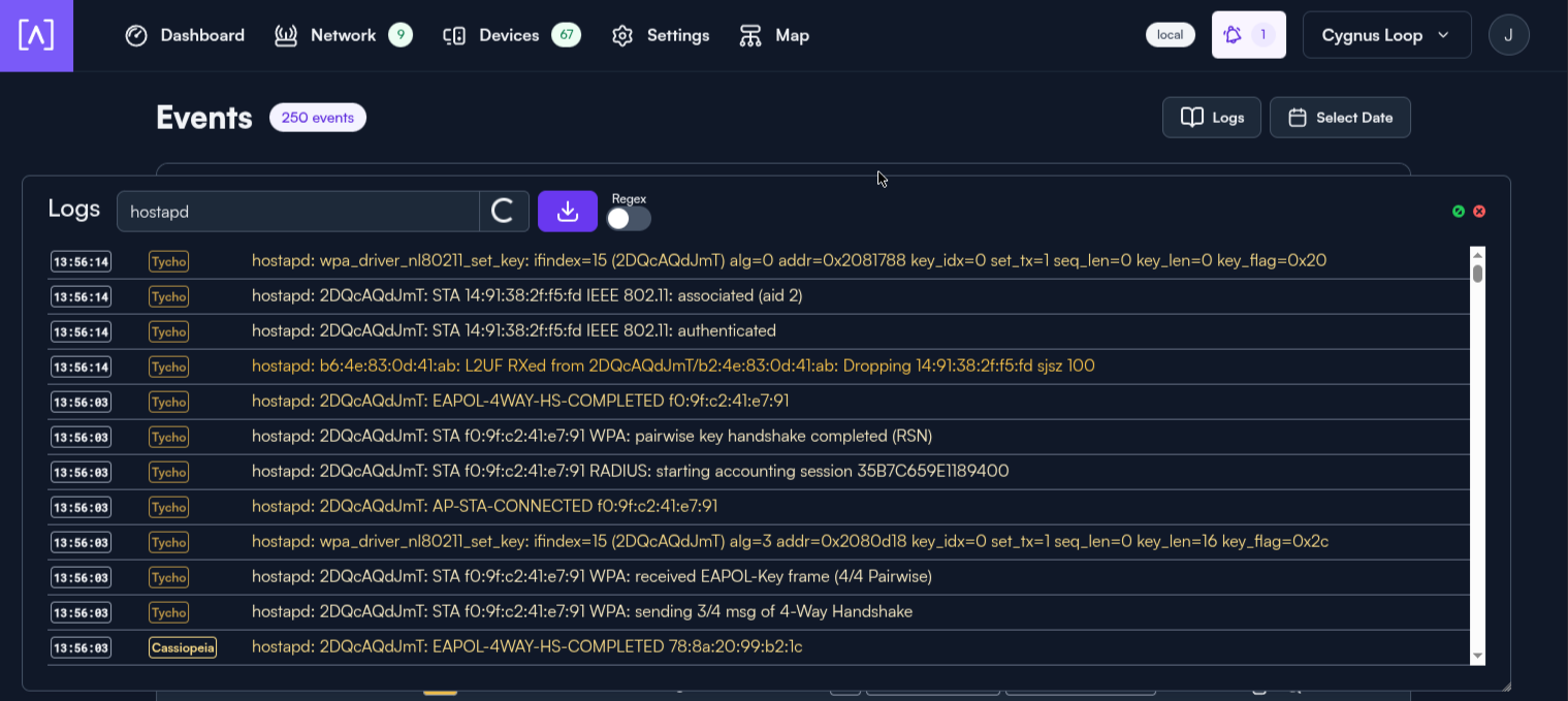

By default, Logging is enabled and active. It cannot actually be disabled, so you should always have access to logs from connected & online devices. To locate the logs, click the alerts button with the bell icon from any tab in the management platform, then use the Logs button below the navigation header.
Sharing logs
With the purple download button next to the search bar, you can download a copy of the logs resulting from your filter. This can be easily shared with our support team by emailing it to support@alta.inc or using this link. You may also want to download these for your own records, or to send to your colleagues and coworkers for extra analysis.
Searching the logs
Important Note: If you supply nothing in the search bar and click the magnifying glass (or press enter while the cursor is in the search bar), all logs from all devices will start streaming in. We do not do this by default to avoid streaming excessive amounts of data by default.
Across the top of the logs window you will see a search bar, a download button, a Regex toggle switch, and finally the two window controls on the far right to expand the window or close it entirely.

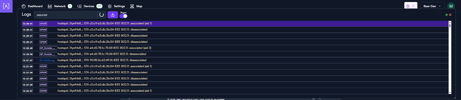

The window will be empty by default until you input a search. Try some simple terms such as err, warn, hostapd & mwan3 in order to see the effect. Once a search term is added, log lines matching the filter will continue to populate the window in real-time as they are generated by system activity. For more advanced filtering, toggle on Regex and continue reading for more information.

In the above example, note that the intent was to look for all WiFi associations and disassociations. In this case, . is used as well as a number of letters that would appear in both “associated”, “disassociated”, and will match any word that contains “associat”. Also note that the Regex toggle is set to on. The output shows me all log entries where a device either associated or disassociated with any AP on this network.
Also note that the log will update nearly real-time with the filter applied.

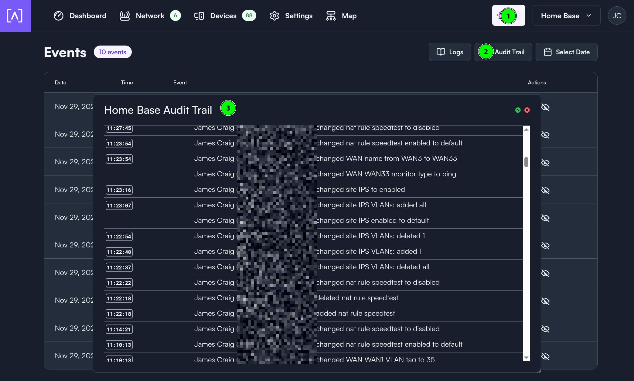

Site-wide Audit Trail
The full audit trail for the selected site is available under Events (notification bell) → Audit Trail. This view shows all recorded configuration actions across the site, including but not limited to changes to networks, WANs, firewall rules, IPS, VLANs, and user management.

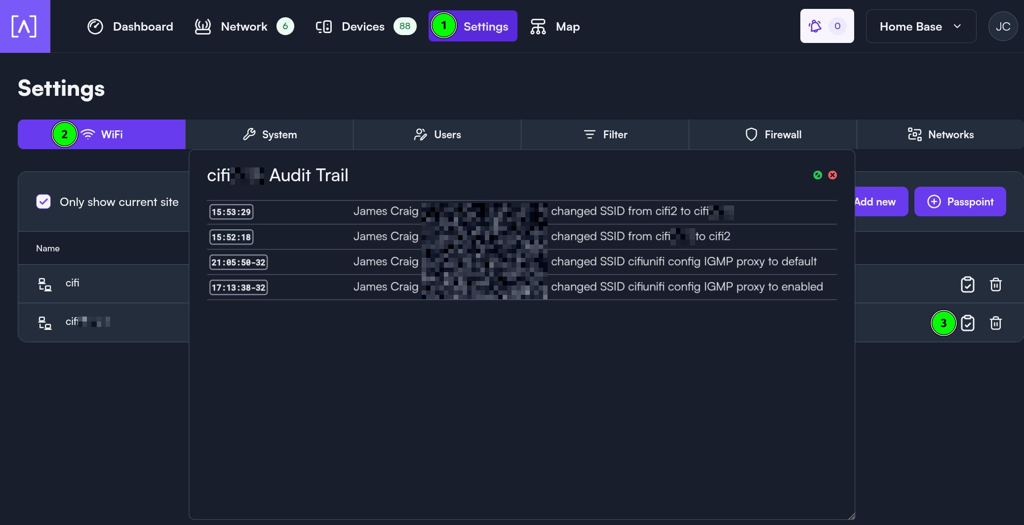

Per-SSID Audit Trail
SSID-specific audit data can be accessed within Settings → WiFi, by selecting the SSID and opening its Audit Trail panel. This view shows changes scoped only to that SSID (e.g., SSID name changes, security settings, VLAN/IGMP adjustments).
