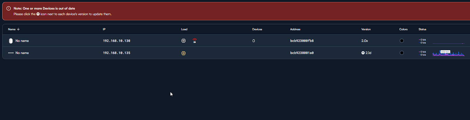

  1. Ensure your switch is running the latest firmware:

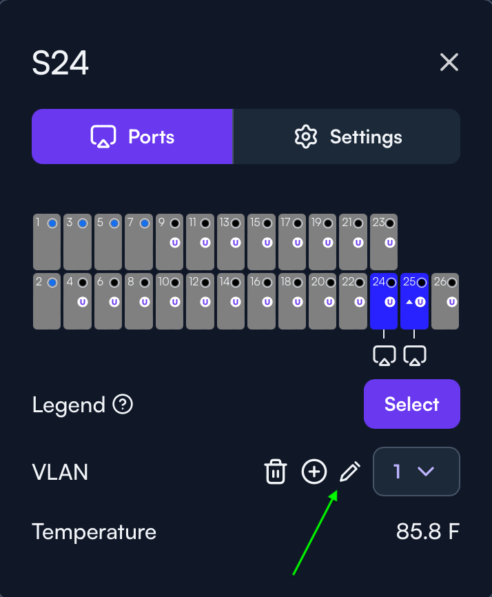

  2. IGMP Snooping: You can enable IGMP Snooping on a VLAN by accessing any of the switch setting cards on your site. Click the edit icon next to the appropriate VLAN.  With IGMP Snooping enabled, both Fast Leave and Querier are then both enabled.

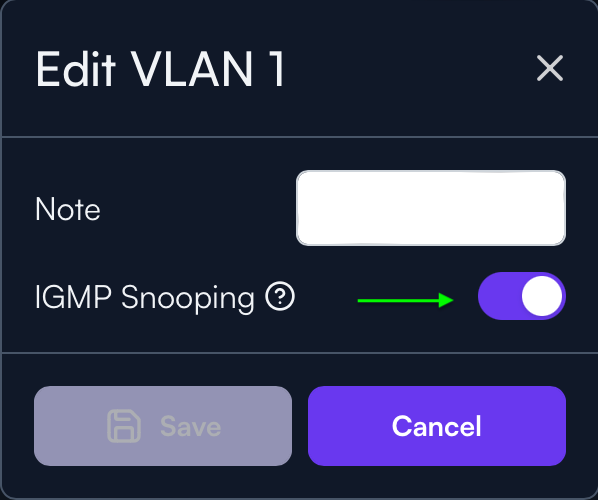

    A new window will appear where you can toggle whether IGMP Snooping is enabled for that specific VLAN.
