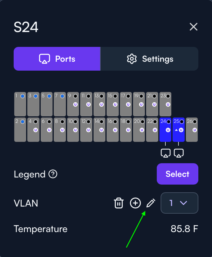

  1. IGMP Snooping: By default, Dante operates in a Unicast format. However, Dante allows for Multicast groups to be set up. If you opt to use Multicast groups, we recommend enabling IGMP Snooping so the Alta Labs network switches can help assure multicast traffic is only sent to ports that subscribed to the appropriate multicast streams. This helps remove any unwanted network congestion, especially if you have more than a few dozen audio endpoints. You can enable IGMP Snooping on a VLAN by accessing any of the switch setting cards on your site. Click the edit (pencil) button next to the selected VLAN. With IGMP Snooping enabled, both Fast Leave and Querier are then both enabled.
A new window will appear where you can toggle IGMP Snooping for that specific VLAN.
