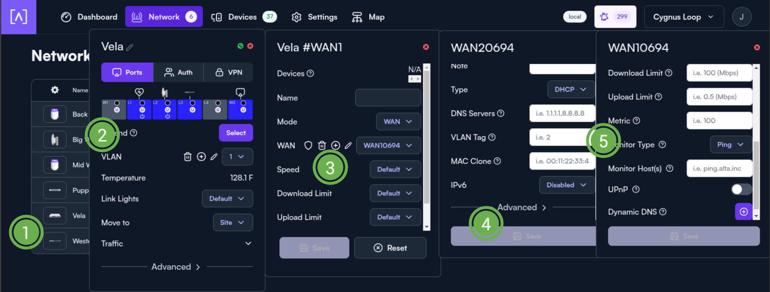

Navigate to the Networks tab in the management interface (https://manage.alta.inc or Alta Networks mobile app). Click the Route10 icon, then the interface in which your internet uplink is connected. Edit the WAN configuration by clicking the pencil icon, expand the Advanced section, and finally define the Metric.
Repeat this process for your second (and additional) WAN interface. For each Metric, ensure that the value is always the same.
Warning: Differing values will result in failover mode instead. See here for our article regarding that topic.
