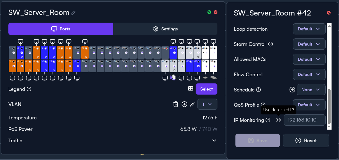

  1. Open the Alta Labs management interface and select the desired switch.
  2. Select the PoE port connected to the device you want to monitor.
  3. Under the port settings, locate IP Monitoring.
  4. Enter the IP address of the device that should be monitored. If an IP address has already been detected on the port, you can click the double arrows to load the detected IP into the field.
  5. Click Save

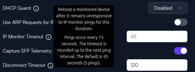

Once enabled, the switch sends a ping to the configured IP address every 15 seconds.
By default, the IP Monitor Timeout is 45 seconds. This means the monitored device must fail to respond to three consecutive pings before the timeout is reached:
  • 15 seconds — First failed ping
  • 30 seconds — Second failed ping
  • 45 seconds — Third failed ping, this triggers the port powercycle
When the timeout is reached and the monitored device remains unreachable, the switch automatically power-cycles PoE on that port.
After power-cycling the port, IP Monitoring waits 3 minutes before beginning monitoring again. This recovery period gives devices that take longer to boot time to start up and re-establish network connectivity before they are evaluated again.
You can override the interval on a Site-by-Site basis:
  1. Go to Settings
  2. Expand Advanced
  3. Scroll until you see the IP Monitor Timeout section
The default 45-second IP Monitor Timeout corresponds to three failed ping attempts. Because pings occur every 15 seconds, timeout values are effectively evaluated in 15-second intervals.
