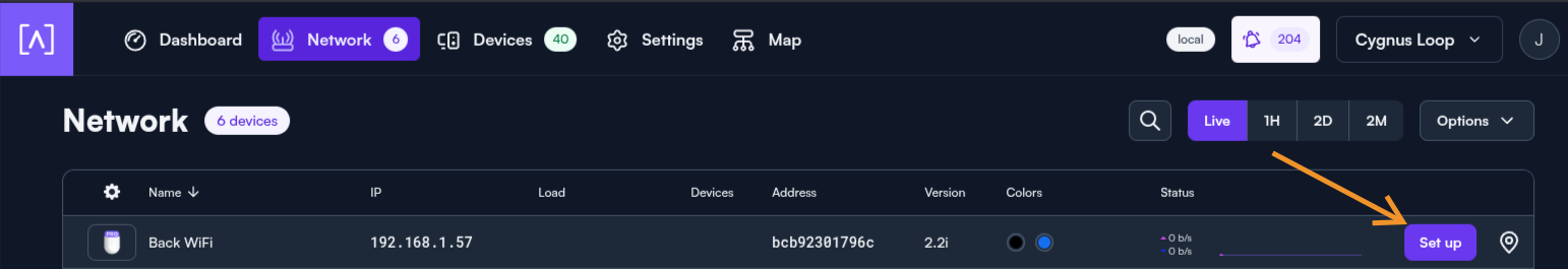

Setup the device
The device will automatically connect to https://manage.alta.inc and enable you to provision it from the management platform. Ensure you are logged into your account, and that you are connected to the same internet connection as your new switch. After a few moments, the device will appear under the "Network" tab with a Setup button. Click Setup and the device will then be managed and provisioned as you make changes within the app or web dashboard.
NOTE: It may be possible that the Setup button is hidden in the row, and requires that you scroll the table to the right in order to find the correct column.
