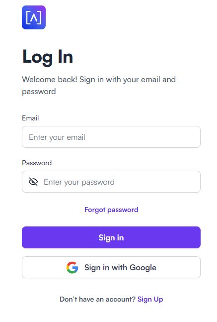

Step 1: Log in to manage.alta.inc

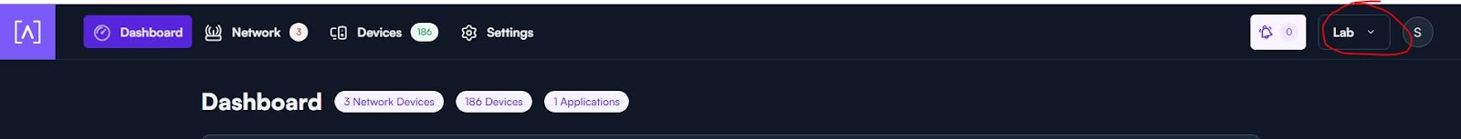

Step 2: Select the site
  • Select the site you want to add a Hotspot to by using the drop down menu in the top right corner of your screen.

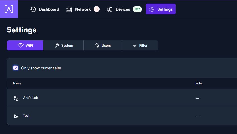

Step 3: Select the desired SSID
  • Once you have selected the site you want to configure, head over to Settings. Select WiFi and choose the SSID you will be adding the Hotspot to.

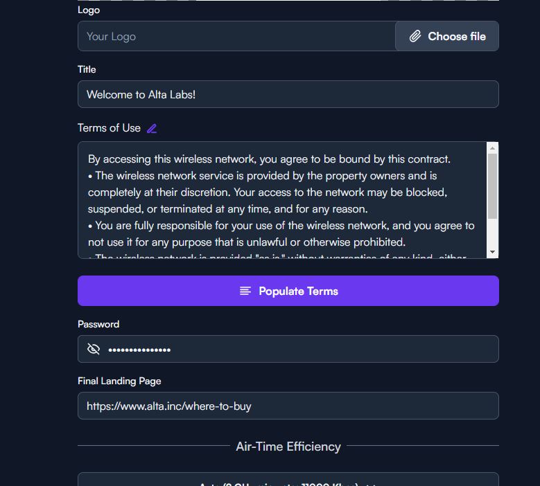

Step 7: Add a logo
  • Upload your logo or image that you want to be associated with the Hotspot. Supported file types are: JPEG, PNG, and SVG.
Step 8: Add a Title/Terms of Service
  • Add a title you want to be displayed to users logging in via Hotspot. For the Terms of Service, you can use the predefined template, modify it, or define your own Terms of Service that users agree to before they are allowed access to the internet. You can also retitle this section altogether by the "Edit" icon, next to the Terms of Service.
Step 9 (Optional): Add a password
  • Enter the password that you want to provide users to join the network via the Hotspot. If you simply want users to see the Terms of Use and continue without entering a password, leave this field blank.
Step 10 (Optional): Enter landing page URL
  • If you want to redirect users to a landing page upon successful login, you can enter the URL in the "Final Landing Page" section.
Hit save and now the Hotspot is running. Now all users that login to the SSID will be presented with the information you have added during setup.
