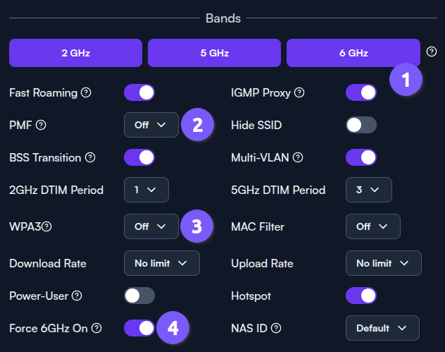

However, 6GHz can be forced on, if desired. If forced on, 6GHz will only work for the first AltaPass in the list for a given SSID. If you look at the Advanced Settings for an SSID, you'll see the following:
  1. Band selection now shows 6GHz as an option and all 3 bands are enabled by default. This has no impact for non AP7-Pro APs, they'll only transmit 2.4GHz and 5GHz, of course.
  2. PMF - Protected Management Frames
  3. WPA3
  4. Force 6GHz On
If you have multiple AltaPasses set up, the only thing you need to do to use 6GHz is toggle on "Force 6GHz On". This will enable 6GHz only for the first AltaPass in the list. Subsequent AltaPasses will only be able to use 2.4GHz and 5GHz.
Since PMF and WPA3 are required on the 6GHz band, the firmware will automatically enable those settings on any 6GHz SSIDs, even if they are disabled by configuration in the management platform.
In order to enable WPA3 on the 2.4 and 5 GHz bands (which is not recommended, but is possible for enhanced security), set the PMF and WPA3 dropdowns to On. This is a "maximum compatibility mode; devices that support WPA3 and understand Protected Management Frames will use WPA3, devices that don't support WPA3 and understand Protected Management Frames will use WPA2. However, keep in mind that by doing this, the 2.4 and 5 GHz bands will also be limited to the same restriction where clients that are using WPA3-Personal for authentication will be unable to use any other password than the first one.
