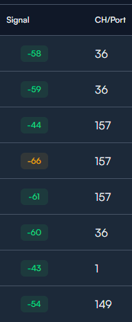

  1. Check the band and signal levels of the Sonos devices
    • Head over to the Devices tab
    • You can click the Make column to sort by Manufacturer, then scroll to Sonos or you can use the search bar and search “Sonos”
    • Under the Signal column, you can mouse over the icon to get your raw, numerical signal reading
      • Alternatively, you can go to Settings > System > WiFi Signal > Switch to “Raw” to have the value displayed instead of the WiFi icon.
    • Any signal below a -75 (these are negative so -76 is worse than -75) will almost certainly cause issues. An ideal signal is going to be in the -55 to -65 range
      • There is such a thing as too strong of a signal. Anything better than -35 has the potential to cause stability and/or performance issues
These signals are all pretty good. Note that there is one outlier for both band and signal, 2nd from the top. This one is on the 2.4 GHz band channel 1. Channels 1-11 are in the 2.4 GHz space and channels 36-165 are in the 5 GHz band. Realistically speaking, this one has such a strong signal on 2.4 GHz that it could be viable on the 5 GHz band.
Any devices that appear like they’re logically on the incorrect AP or band, you can click the Reconnect icon to force them to disconnect and reconnect to the WiFi
