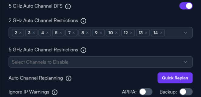

As you see in the above screenshot, there are other parameters to configure automatic channel planning.
5GHz Auto Channel DFS
This toggle allows the channel planner to choose channels within the Dynamic Frequency Selection (DFS) range. This opens up a large portion of spectrum in the band, but is susceptible to increased risk of disruption from higher priority equipment which require the access point to change to a different uncontested channel for a minimum time period. For example, a weather station may perform an operation on the 5GHz band, causing the AP to switch channels and interrupting service for a brief time.
2GHz Auto Channel Restrictions
By default, only channels 1, 6 and 11 are allowed for automatic channel planning. It is not recommended to change this default in most environments, but you may configure the channel allowances here.
5GHz Auto Channel Restrictions
There are no default restrictions for 5GHz auto channels, aside from the DFS toggle above. If you need to implement some limits, you may configure the channel allowances for 5GHz here.
