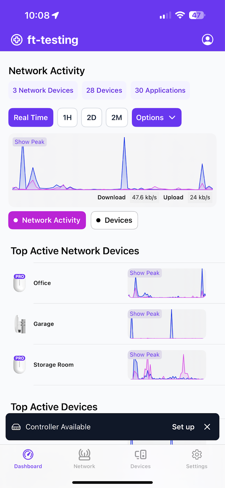

Alta Labs Mobile App
  1. If the unconfigured controller isn’t automatically presented to you within the app, tap on the Account icon on the Dashboard, and then tap on Controllers.
  2. Once the new controller has been discovered via Bluetooth, enter the email address of the controller administrator. This user will have administrative control over the controller.
  3. Follow the steps within the app to create your first new user on the controller.
