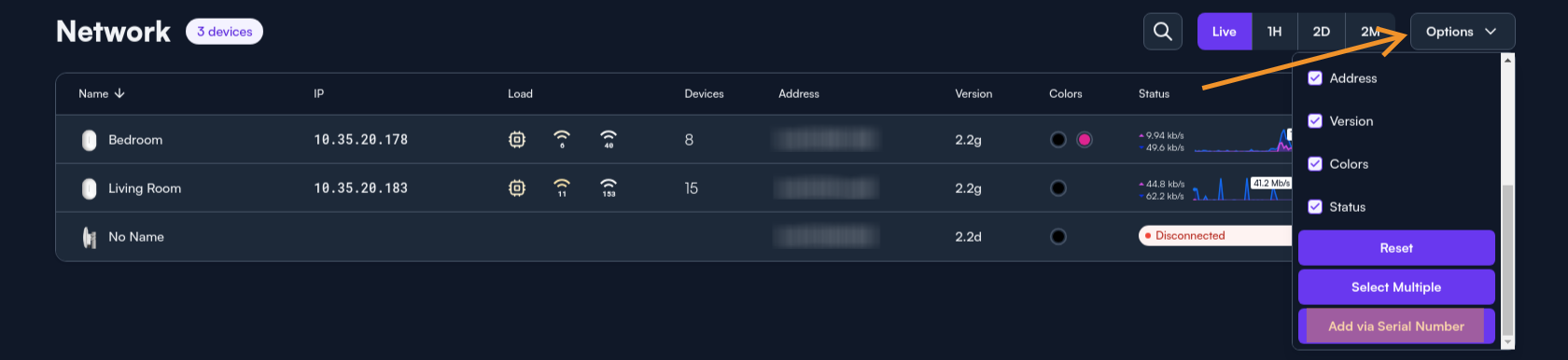

Ensure that you are managing the correct site at https://manage.alta.inc. From the Network tab click the Options menu. Scroll to the bottom and click Add via Serial Number. Input the full serial number printed on the device's box or the label on its back.
