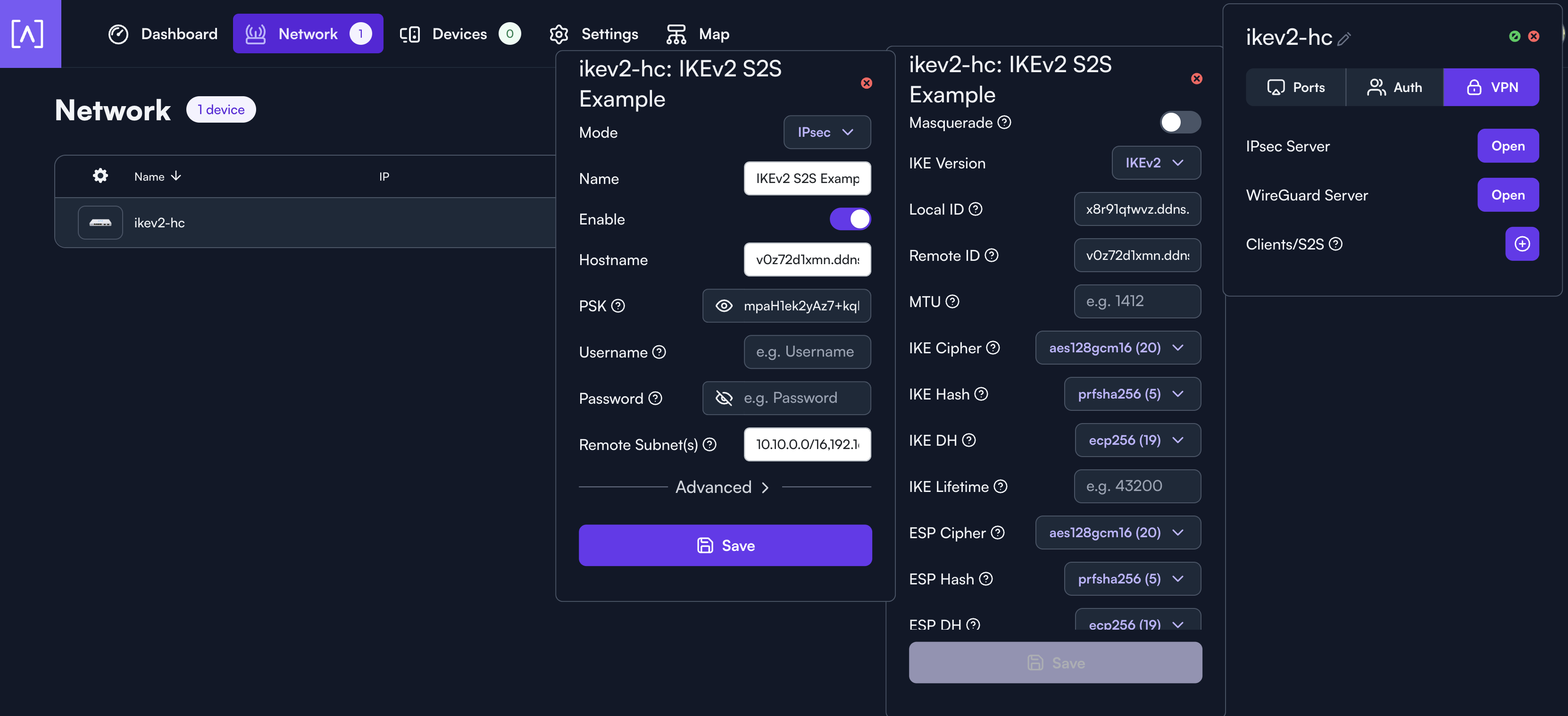

1. Basic Configuration
For most setups, only a few fields are required:
  • Enabled
    Turn the VPN tunnel on. Default: on.
  • Name
    A label for your reference. Not technically required, but it’s best practice to give it a descriptive name.
  • Hostname
    The IP address or hostname of the remote peer.
  • Pre-Shared Key (PSK)
    A shared secret used for authentication. You can auto-generate a secure PSK by hovering over the question mark and clicking where it says “Click.” This PSK must be the same on both sides of the link.
  • Remote Subnet(s)
    The network(s) on the remote peer’s side that should be routed through the tunnel.
    Use CIDR format, comma-separated, no spaces.
    Example: 192.168.2.0/24,10.0.0.0/16
  • Local ID
    The identity this device presents to the remote peer. By default, input the Alta DDNS hostname of the current site.
  • Remote ID
    The identity you expect the remote peer to present. By default, input the Alta DDNS hostname of the remote site.
How to look up the Alta DDNS hostname (if needed):
  1. Go to the Network section.
  2. Hover the mouse cursor over the IP address for Route10.
  3. Move the cursor over the hover modal that appears.
  4. Triple-click the DDNS hostname line to fully select it, or click and drag to highlight it manually.
  5. Press Ctrl + C (or + C on Mac) to copy the line, or right-click and choose Copy.

3. What Happens After Saving?
  • The system attempts to initiate the IKEv2 handshake using the configured parameters.
  • If successful, traffic to the remote subnet(s) will be routed over the tunnel.
