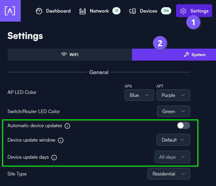

Where to Find Device Update Settings
In the Alta Labs Controller, navigate to:
  1. Settings
  2. System
The following pertinent settings are available:
  • Automatic Device Updates
  • Device update window
  • Device update days
Automatic Device Updates must be enabled for automatic firmware updates to use the configured update window and update days.
