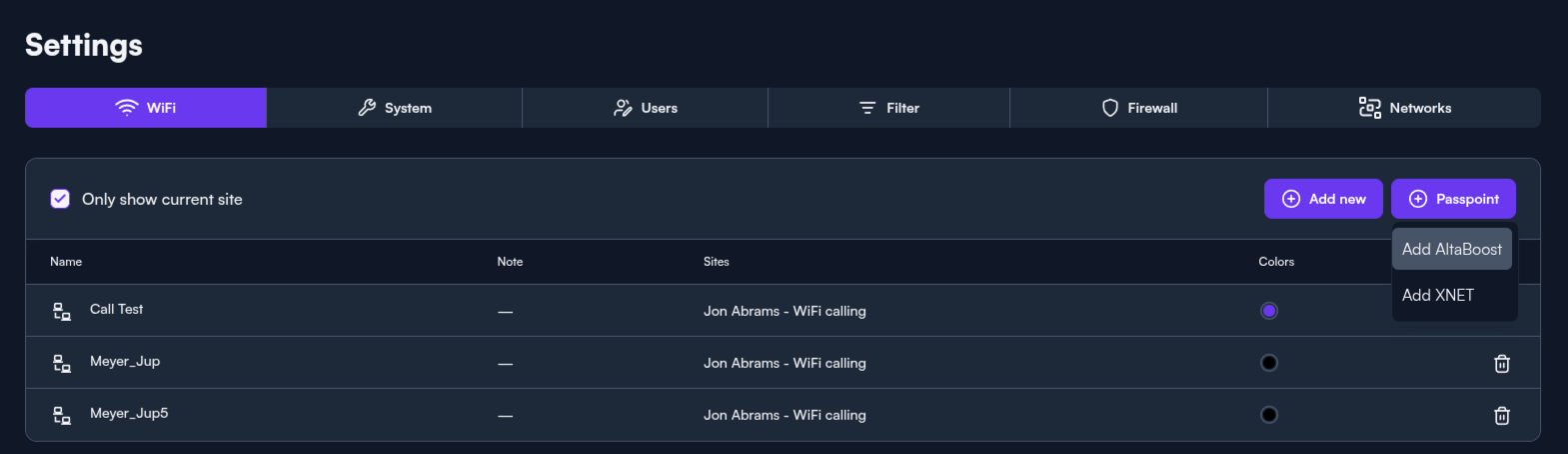

Enabling AltaBoost
Log in to https://manage.alta.inc or the Alta Networks mobile app and ensure you have selected the site you wish to enable AltaBoost for.
  1. Navigate to Settings
  2. Click the Passpoint button
  3. Click Add AltaBoost
By default, AltaBoost comes pre-configured, so no further setup is required. The system automatically applies the correct SSID parameters for carrier offloading. However, you may optionally adjust advanced settings – for example, assign a specific VLAN for AltaBoost traffic, set bandwidth limits, or customize the SSID’s color indicator. Just remember to save any changes. (We strongly recommend using a dedicated VLAN for AltaBoost, as discussed in the Securing AltaBoost section below.)
