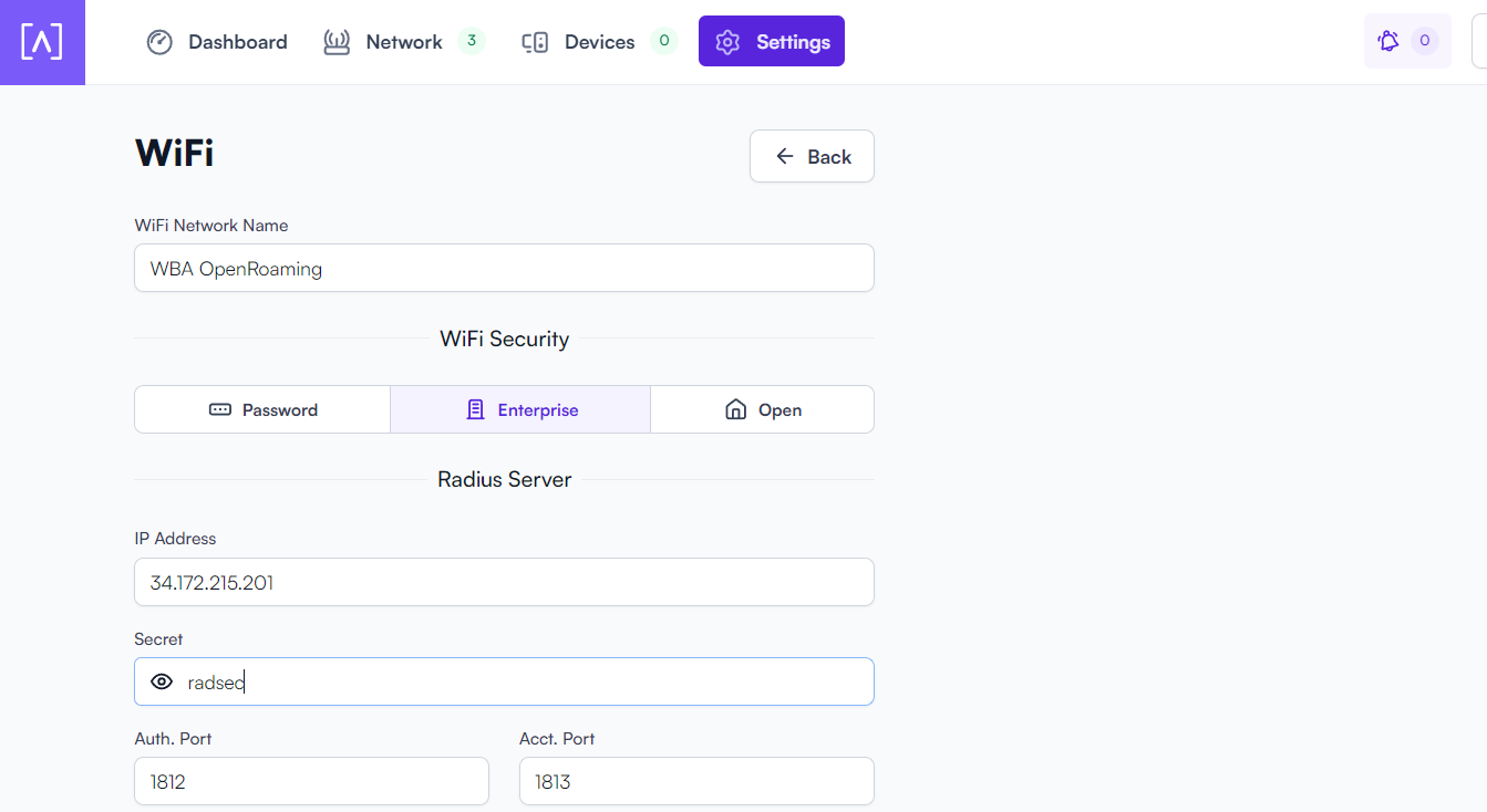

Setting up a test SSID for Passpoint (previously known as Hotspot 2.0) using OpenRoaming is a quick process that only takes a few minutes. The first thing you need to do is create your test SSID. You can do so under Settings > WiFi > Add New, whether from the web or on mobile.
WiFi Network Name: WBA OpenRoaming
WiFi Security: Enterprise
IP Address: 136.65.149.146
Secret: radsec
Configure Advanced Settings

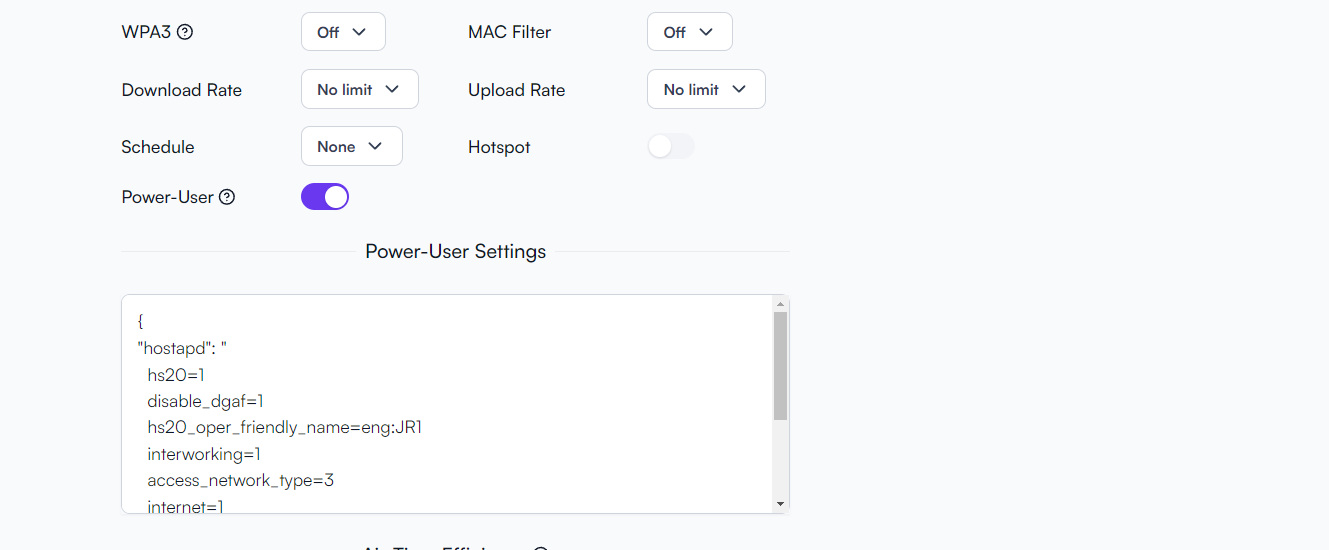

  4. Scroll down and enable Power-User.
  5. In the Power-User section, paste the following JSON snippet:
    "hostapd": "
    hs20=1
    disable_dgaf=1
    hs20_oper_friendly_name=eng:JR1
    interworking=1
    access_network_type=3
    internet=1
    roaming_consortium=5A03BA0000
    radius_acct_interim_interval=300
    venue_name=eng:WBA
  6. Click Save to apply the changes.
    If your provider requires additional parameters not currently listed, you can reference the hostapd configuration documentation HERE. You would add parameters in the same format as the other parameters, between the opening and closing quotes.
