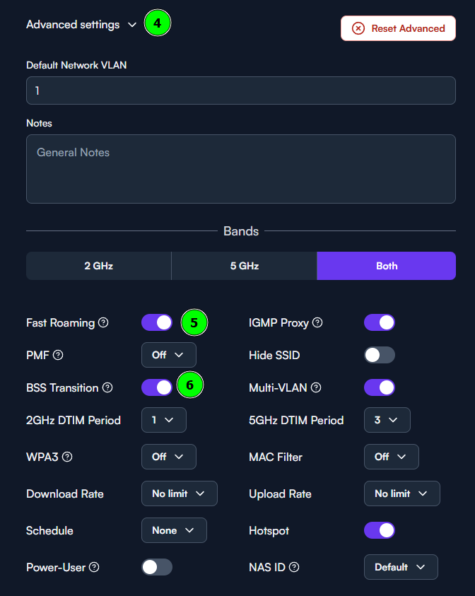

As a general rule, there are only 2 settings that are pertinent in order to support WiFi calling.
  1. Start by logging in to your account at https://manage.alta.inc, these settings are also available via the iOS and Android apps, the steps are the same
  2. Go to Settings
  3. Click on the relevant SSID
  4. Expand the Advanced settings menu at the bottom
  5. Locate the Fast Roaming toggle and ensure it is set to On (off by default)
  6. Locate the BSS Transition toggle and ensure it is set to On (on by default)
  7. Scroll to the bottom and click Save

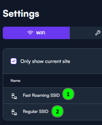

I performed these steps and device(s) went offline
This can be expected and is also the reason we do not have Fast Roaming enabled by default.  Some older devices and certain IoT devices either don’t support or are not well supported with Fast Roaming enabled.
Fast Roaming is an SSID wide setting, so the simplest solution is to have an SSID with Fast Roaming disabled and create another SSID with Fast Roaming enabled.
  1. Fast Roaming enabled
  2. Fast Roaming disabled
When creating the alternative SSID, ensure that the SSID itself is unique. e.g. don’t have 2+ SSIDs that are identical.
