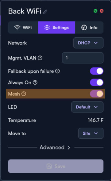

You may disable this for any individual access point by navigating to the Network tab and then clicking its icon in the far left column. In the configuration card, click the Settings tab and then toggle the Mesh switch.

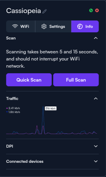

Check for interference from the access point's Info tab. See here for more details on reading the results.
