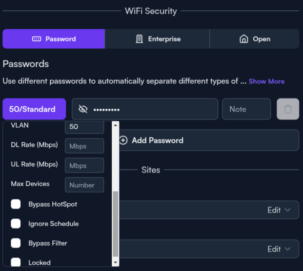

Settings
By clicking the purple button to the left of the password, you can configure more granular settings. Each password can have its own unique configuration applied here.

VLAN
If you have defined a VLAN (see here) then you may associate it to this password.
DL Rate (Mbps)
Limit the maximum download speed per client in megabits per second.
UL Rate (Mbps)
Limit the maximum upload speed per client in megabits per second.

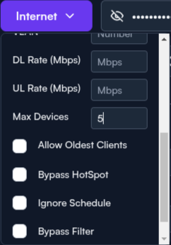

Max Devices
Limit the maximum number of simultaneously connected clients. Setting a value will show an additional option - Allow Oldest Clients. Leaving it unchecked will cause new clients to replace the oldest clients. If checked, when the maximum is reached, any new clients will be rejected instead. In both cases, a captive portal will alert the client that the device limit has been reached.
Bypass HotSpot
If you are using a HotSpot (see here), then you can allow users to bypass it.
Ignore Schedule
WiFi scheduling can be ignored (see here), allowing users to stay online when the WiFi is disabled.
Bypass Filter
Bypass the content filter (see here).
Locked

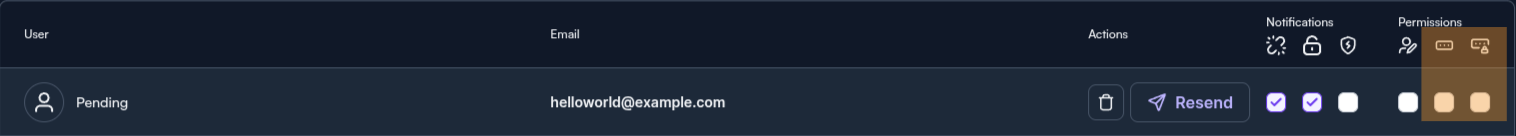

Locked passwords are accessible only to admins and users with the All Password Access permission. Admins can view and manage these passwords, while non-admins with access can view only. Use the Locked setting to keep specific Wi-Fi credentials private. Permissions can be set when inviting users or adjusted later in their profile via Site Management as seen below.
